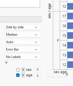

I had to use Merged to zip the labels on the Y axis. Why?
JMP doesn't allow a user to disable "variables" when they are nested :
Without the Merged option, the plot would look like this - Female and Male ages nested:
On the other hand:

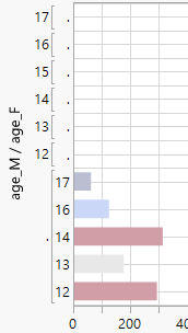

a)
Merged leads to the wrong labels on the Y axis: 1,2,3... instead of 12,13,14 ...

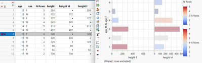

b) It's systematic, but dangerous:
To see the issue, just generate the plot with one missing entry (e.g. NO female, 15 years):
As "Merge" replaces the labels with 1, 2, 3 ... this makes the bars for Female shift and misaligns them to the male bars (!)

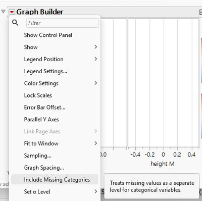

By the way - on my system, the default setting is
So, If your graph is empty:
go to the red-triangle-menu and activate the option.

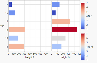

with the two options:
@hogi wrote:
in addition, either split color or the age axis:
better forget the second one - and use the first one:
Graph Builder(
	Transform Column( "N_M", Formula( If( :sex == "M", :N Rows ) ) ),
	Transform Column( "N_F", Formula( If( :sex == "F", :N Rows ) ) ),
	Variables( X( :height F ), X( :height M ), Y( :age ), Color( :N_F ), Color( :N_M ) ),
	Relative Sizes( "X", [360 237] ),
	Elements( Position( 1, 1 ), Bar( X, Y, Color( 1 ), Legend( 1 ) ) ),
	Elements( Position( 2, 1 ), Bar( X, Y, Color( 2 ), Legend( 2 ) ) ),
