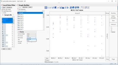

Whenever I try to plot a number of columns at once, I cannot choose color by any other columns because "Maker" seems to have the highest priority of color.
For example, on the bottom image, I tried to change color by Sample, but all dots were purple because "Maker" was set to purple.
Could someone tell me how to get rid of "Maker" so that I can choose any colors I want?

If possible, it would be helpful to see an example of your data table and graph to check if there are any customizations that are not visible on the plot you shared (e.g. row state in the table, or graphic elements in the plot). Also, I noticed that under the sub-menu "Points", you have the "Error Interval" checked as "Error Bar": is it possible to check that back to "Auto"?

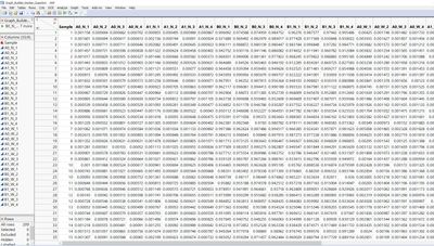

Let me show you my data table.
I didn't set any row or column state.
Let me show you "Interval Style".
There is no "Auto" menu here.
