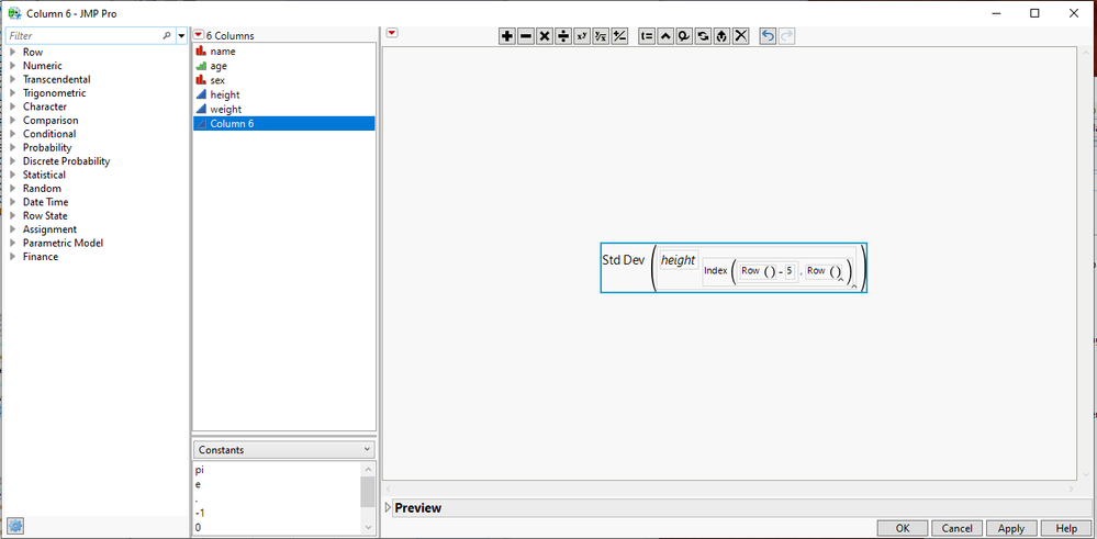

This is a formula.  My error in assuming that you would understand that :Height is a reference to the column to perform the standard deviations on.  The ":" in front of the column name is a scoping element, telling JMP that Height is a column in the data table, not a memory variable.  The Height column is found in the Big Class sample data table.  It is probably the most familiar data table to the JMP Community.  It is used a lot to illustrate how to do different things in JMP.  It is available in the Sample Data Library under the Help pull down menu.

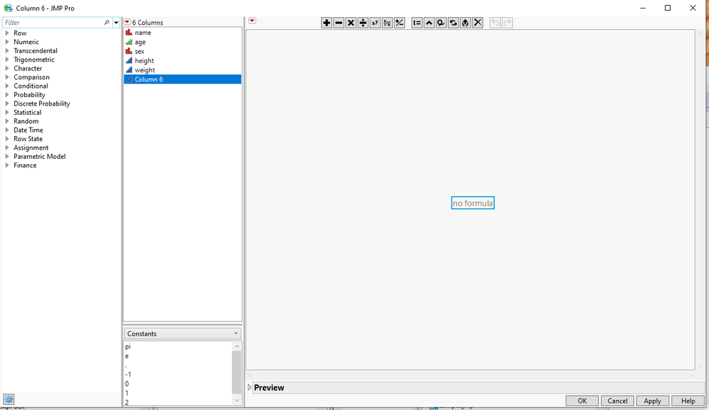

To copy the formula into the Formula Editor, open the editor( create a new column, go to the column header and right click and select "Formula")

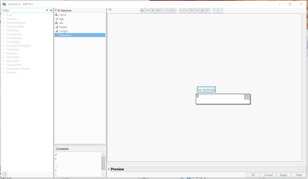

move your cursor to the "no formula" box,
and right click and "Paste" the text into the box
The Formula Editor creates an enhanced display of the formula.  To edit the formula further, double click on any blank space within the formula, and an editor window will pop up
