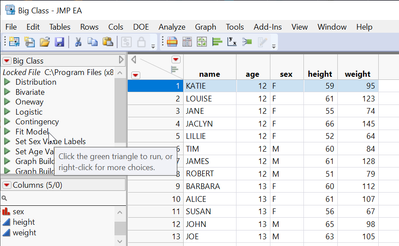

Did you check out the BigClass example file. There is a "Fit Model" with different data Modeling type.
