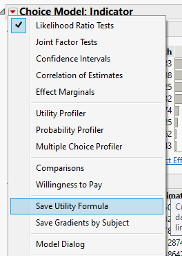

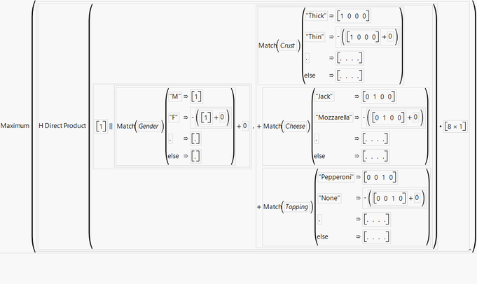

Try saving the utility formula from the red triangle menu. Perhaps you can program that in your other software.
