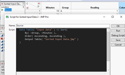

1. Sorting. I first sorted the data table using the Tables...Sort command, then I looked at the "Source" script saved to the new data table, and copy/pasted it into a new script window (I did add a "dt = " at the beginning and a semicolon at the end, so you do have to have a tiny bit of scripting know-how).

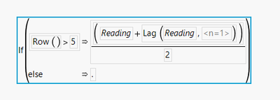

3. I typed in "dt << new column ("Rolling Slope", numeric, set formula (xxx));", then I made the formula in the GUI, and copy/pasted it to replace the "xxx" section of code.
