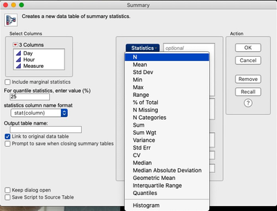

It would be helpful to us if you provided what OS and version of JMP you are on.  Additionally, if you can provide the dataset (you can code it).  I don't know exactly what you've got, but using Tables>Summary gives many options for calculating and storing statistics.

I am currently using macOS Big Sur 11.6 and JMP version 16.0.0. I tried using the table function but I didn't really understand how to use it. Unfortunately I cannot provide the data set.
