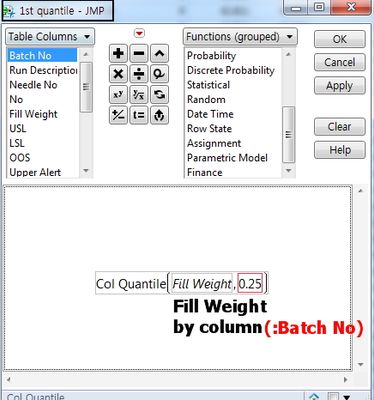

Hi~
I'd like to calculate Col Quantile by Columns
on the data table
by using JMP formula as below.    (Note. Not from 'Tabulate' menu)
Do you have any idea with this?
Thanks in advance. : )

Unfortunately, the Col Quantile function does not support a By variable. However, you can use the following formulas to get around this limitation:
//Examples using $SAMPLE_DATA/Big Class.jmp:
//When By variable is character-valued:
Quantile( 0.25, (:height << get values)[loc((:sex << get values),"M")] )
//When By variable is numeric-valued:
Quantile( 0.25, (:height << get values)[loc((:age << get values) == :age)] )
Hopefully, one of these two will work for your situation!

Re: Calculating Col Quantile by columns
Using Michael's approach, you can also do the following for the character-valued scenario, to avoid having to list each group value explicitly:
Quantile(
0.25,
  (:height << get values)[Loc( :age << get values, :age[Row()] )]
If you need to use more than one grouping variable (say, 3 columns together, for instance) you would first concatenate the columns together to form a fourth, and use this new column as a (single) grouping column.
Brady,
Thanks for catching my typo! I meant for the character-valued case to be this:
Quantile( 0.25, (:height << get values)[loc((:sex << get values),:sex)] )

Steve_Kim
Level IV
WOW!!!!
It's marvelous solution!
and I learned 'get values' and 'location' formula from you.
Thank you so much  Michael and Brady!
