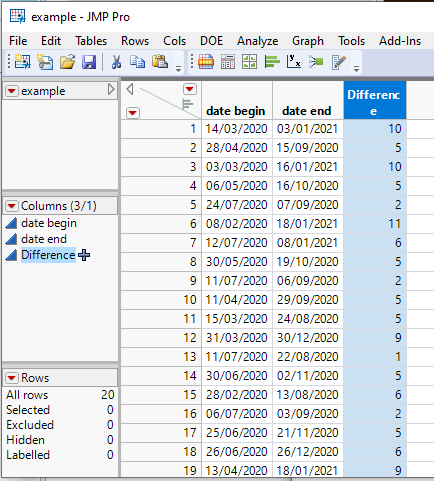

Assuming your "date begin" and "date end" columns are valid JMP Date/Time values, then the new formula for calculating the difference is
Date Difference( :date begin, :date end, "month" )
Here is an image of the attached example data table that has the date begin and date end columns and a new column, Difference that uses the above formula

I suspect that my Example data table confused the issue.  I have attached a new example data table.  It has 2 columns which represent the beginning date(date de début) and the ending date(date de fin).  I assume that you have a data table that has such columns.  All that needs to be done, is to then add a new column which in the example data table is called "Columne 3", which is the column that takes the beginning date and ending date columns and finds the difference.
