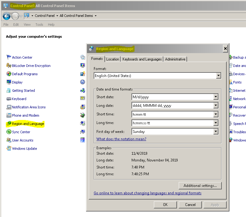

Craige_Hales
Re: CVS files with date columns open as characters
I'm just guessing...if this isn't the answer, you'll need tech support. I'm assuming you are using Windows, Mac probably has something similar. It is possible JMP is using the localization settings and something is different (language, perhaps.)
windows localization settingswindows localization settings
Craige
