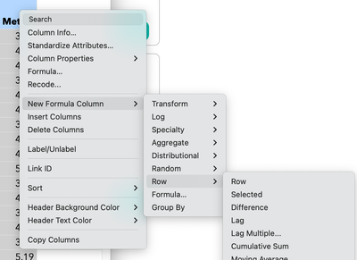

It sounds like you want to plot the cumulative sum of X over time? Kind of like a forecast.
right click on your metric column, choose New Formula Column>Row>Cumulative Sum.  This puts the cumulative sum formula in a new column
