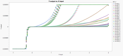

Victor_G
Re: Bug with GraphBuilder? Plot Y vs X
Hi @ChesterKnurek,
I guess this is what you expect on JMP ? :
If yes, two steps to make it work :
  1. On your original datatable, stack your various X columns together in order to have only one column for X values.
    Script for your datatable :
    Data Table( "XXXXX_ROW1_IV-1" ) << Stack(
    	columns(
    		:"4"n, :"3.95"n, :"3.9"n, :"3.85"n, :"3.8"n, :"3.75"n, :"3.7"n, :"3.65"n,
    		:"3.6"n, :"3.55"n, :"3.5"n, :"3.45"n, :"3.4"n, :"3.35"n, :"3.3"n, :"3.25"n,
    		:"3.2"n, :"3.15"n, :"3.1"n, :"3.05"n, :"3"n, :"2.95"n, :"2.9"n, :"2.85"n,
    		:"2.8"n, :"2.75"n, :"2.7"n, :"2.65"n, :"2.6"n, :"2.55"n, :"2.5"n, :"2.45"n,
    		:"2.4"n, :"2.35"n, :"2.3"n, :"2.25"n, :"2.2"n, :"2.15"n, :"2.1"n, :"2.05"n,
    		:"2"n, :"1.95"n, :"1.9"n, :"1.85"n, :"1.8"n, :"1.75"n, :"1.7"n, :"1.65"n,
    		:"1.6"n, :"1.55"n, :"1.5"n, :"1.45"n, :"1.4"n, :"1.35"n, :"1.3"n, :"1.25"n,
    		:"1.2"n, :"1.15"n, :"1.1"n, :"1.05"n, :"1"n, :"0.95"n, :"0.9"n, :"0.85"n,
    		:"0.8"n, :"0.75"n, :"0.7"n, :"0.65"n, :"0.6"n, :"0.55"n, :"0.5"n, :"0.45"n,
    		:"0.4"n, :"0.35"n, :"0.3"n, :"0.25"n, :"0.2"n, :"0.15"n,
    		:"0.0999999999999996"n, :"0.0499999999999998"n, :"0"n,
    		:"-0.0499999999999998"n, :"-0.100000000000001"n, :"-0.15"n, :"-0.2"n,
    		:"-0.25"n, :"-0.3"n, :"-0.350000000000001"n, :"-0.4"n, :"-0.45"n, :"-0.5"n,
    		:"-0.55"n, :"-0.600000000000001"n, :"-0.65"n, :"-0.7"n, :"-0.75"n,
    		:"-0.800000000000001"n, :"-0.850000000000001"n, :"-0.9"n, :"-0.95"n, :"-1"n
    	Source Label Column( "X input" ),
    	Stacked Data Column( "Y output" ),
    	Output Table( "XXXXX_ROW1_IV-1-Stacked 6.jmp" )
  2. Then, open the Graph Builder and use the "X input" column as X, "Y output" as Y, and you can use "SET_V" or any other group column as "Overlay". Script to get to the image shown before :
    Graph Builder(
    	Size( 534, 456 ),
    	Show Control Panel( 0 ),
    	Variables( X( :X input ), Y( :Y output ), Overlay( :SET_V ) ),
    	Elements( Points( X, Y, Legend( 9 ) ) )
I also attached the stacked datatable with the graph script directly here if it is more convenient for you.
Hope this answer will help you,
Victor GUILLER
