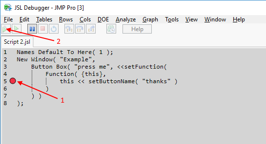

The debugger has to be open before you can set any breakpoints.  I used one of the scripting index ButtonBox examples to demonstrate:
Names Default To Here( 1 );
New Window( "Example",
	Button Box( "press me", <<setFunction(
		Function( {this},
			this << setButtonName( "thanks" )
Click "Debug Script" from the toolbar, Edit menu, or context-click menu.  In the debugger, context-click on the line within the Button Box function to set a breakpoint, and then click "Run" from the toolbar.  The script will then run without interruption until the button is pressed.

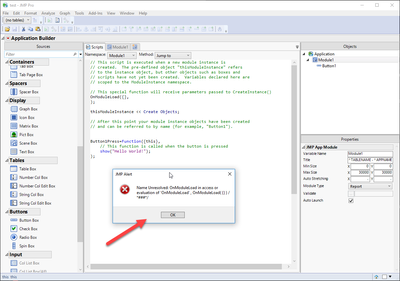

Thanks, but when trying to run any application via a script, I get this error:
Name Unresolved: OnModuleLoad in access or evaluation of 'OnModuleLoad' , OnModuleLoad( {} ) /*###*/
If you run it from the GUI editor tab (Module1), this error does not appear. Hence, I was not sure how to debug these.

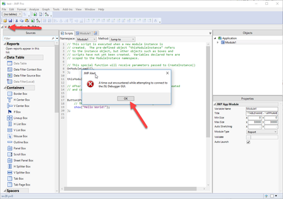

Unfortunately, I get this message when I click "Debug Application":
A time-out encountered while attempting to connect to the JSL Debugger GUI.
Jeff_Perkinson
Re: Breakpoint when debugging an application (GUI)
SN-55411 may help you get the debugger working.
