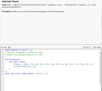

Check out the Scripting Index.

I don't want to have these colors as a one off in one script.
For more context: I would like a way to upload 20 colors and have them be my default color palette and then I want to be able to do this across hundreds of people in one organization.  I am comparing this experience to other software programs that allow you to upload your theme one time and then you are all set.
