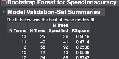

Re: Bootstrap Forest Platform > "validation" column vs "validation" portion
Hi  Victor,
Regarding use of a tuning table for HyperParam search,
I have a mismatch between specified params
and the params reported by Model Validation.
So it looks like that "Portion Bootstrap", "Minimum Splits per Tree" and "Minimum Size Split" are not considered in the model validation. Can you confirm these param names are correct in this context ?
Victor_G
Hi @LargeDormouse25,
Please check the following discussion mentioned in my earlier post, you'll find some explanations about the correct naming of hyperparameters, where to find them, and some tables already prepared with the correct naming for hyperparameters tuning :
Malfunction in Bootstrap Forest with Tuning Design Table?
Victor GUILLER
