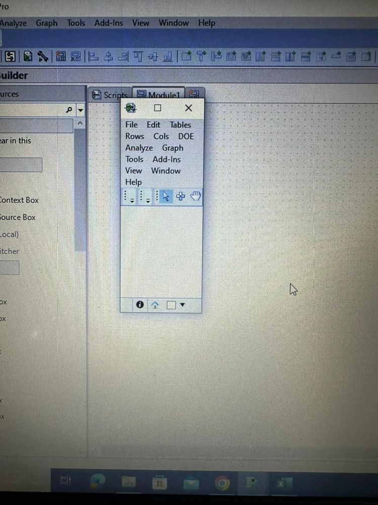

Blank window is getting poped up when jmp application is used.
I have created a blank application and written jmp script for displaying new window in the pace allocated for module1. But when running the application another window is getting popped up. How to address that window in order to make it invisible.

I am attaching the two windows that are getting poppWhatsApp Image 2024-01-08 at 11.43.00 AM.jpegWhatsApp Image 2024-01-08 at 11.43.00 AM.jpegWhatsApp Image 2024-01-08 at 11.43.01 AM.jpegWhatsApp Image 2024-01-08 at 11.43.01 AM.jpeged up.

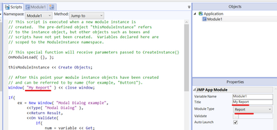

Re: Blank window is getting poped up when jmp application is used.
Hello @Vinusha ,
You can close a report window with the following script.
Window( "My Report" ) << close window;
You can set the name of a report in the Properties pane on the right.
  Hope it works.

Vinusha
Level II
Yeah, That's working. Thank you
