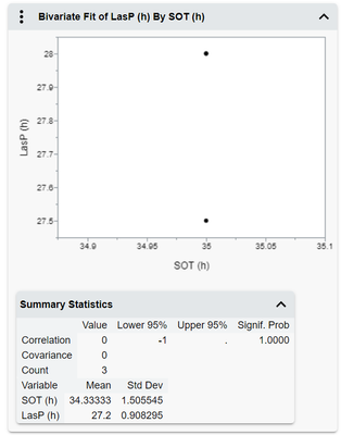

1) Here I performed a Bivariate analysis between two variables. The result I get is correlation = 0. The three points stand on the same vertical line.

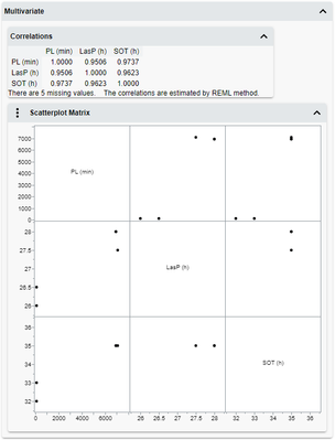

2) If I add one variable and perform a multivariate analysis, JMP automatically selects the REML method. This time, when checking the correlation between the same two variables as above (SOT and LasP), the result is equal to 0.9623!

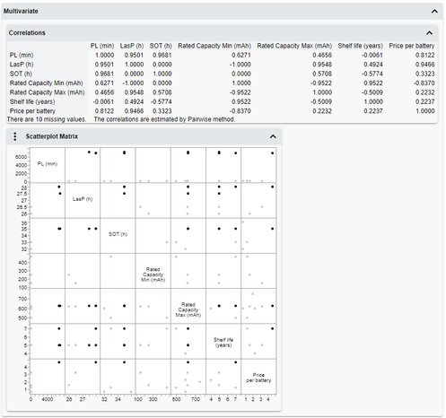

 3) Finally, if I compute a multivariate analysis on several variables including those mentioned above, JMP automatically selects the Pairwise method. The correlation between LasP and SOT is equal to 0 (as it was in case 1).

Re: Bivariate and Multivariate - different results
There are different methods of estimating the correlation coefficient to suit different situations and conditions. Different methods can produce different results for the same data. The pairwise correlation the Pearson correlation coefficient. The other two methods are described here.
