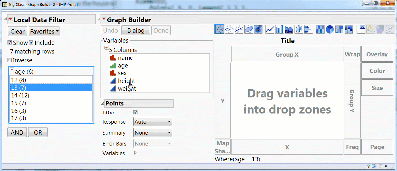

Re: Bivariate Chart - how to connect data points?
Maybe you are after something like this?
Names default to here( 1 );
dt = Open( "$Sample_data/Big Class.jmp" );
dt << Graph Builder(
	Size( 403, 330 ),
	Show Control Panel( 0 ),
	Variables( X( :height ), Y( :weight ), Overlay( :sex ) ),
	Elements(
		Points( X, Y, Legend( 3 ) ),
		Line( X, Y, Legend( 5 ), Row order( 1 ) )
	Local Data Filter(
		Add Filter(
			columns( :age ),
			Where( :age == 13 ),
			Display( :age, Size( 256, 144 ), List Display )
	Size( 403, 330 ),
	Elements(
	Local Data Filter(
		Add Filter(
			columns( :age ),
