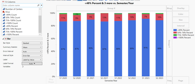

This first one is when I just do the basic plot and do not adjust my y-axis scale. I don't have all my labels, but I have the majority of them.

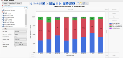

When I adjust my right y-axis scale, which is really the view I need, I get more of my 'green color' labels, but not all and none for purple. My labels for the 'blue color' also disappear.

In first case labels cannot fit to the green and in second case bars aren't visible as they appear on middle of the stacked bars (in my opinion second graph shouldn't be used as it can be very confusing). You might be able to change this "height" where label is but I think it would require extra columns to your table. If users really need to able to read those very small numbers maybe using table to display that information is better (Tabulate could work).
If you really need to show them you can do it with hover labels
