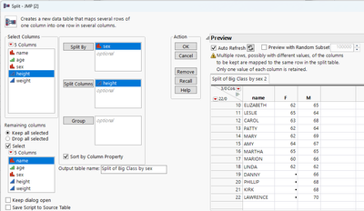

An extreme case for Split:
Keep: name
no grouping column
With sex = M, F, 2 rows are merged into one row and many "names" are lost:
The first *) item wins, so we start with female names, the corresponding male names are dropped.
All male names? no -- at the end, there are some male students left.
*) There is NO universal rule which holds for all tables platforms:
which value will be kept and which value will be lost.
Join also keeps the first value (and doesn't care about subsequent values).

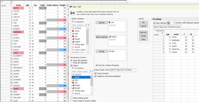

oops  ... this is just true for columns added via Keep.
For the Split Columns, Split behaves like Update: the last one "sticks".
I tried to illustrate it with this example where I marked the "name" entries and the M/F split entries which end up in the final data set. One can see:
- columns added via Keep (like name) : Rank=1 (take first one, skip subsequent ones)
- rows added via Split Columns ( height --> M/F): RankReverse=1 (last one "sticks")

I wonder if Keep All is the right choice as default? If JMP starts with
... then a user who activates the option Keep All can consult the documentation to be sure that it does what he wants.
JMP could even  show a warning: "Are you sure that you want to use Keep? better use Group?"
edit: sorry, I proposed what is already there:
This Platform already starts in "safe mode", with the "Drop all" setting.
And once the user activates "keep all", JMP SHOWS a warning [the one in post N-2].

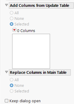

Much more dangerous than Split: Tables /Update
The default interface also starts with "All"
a) for Add Columns
b)  for Replace columns (!)
Some years ago, I considered it dangerous enough to write an AddIn which replaces the default settings with:
The additional befit: with this change the platform doesn't start with a setting that tries to Update thousands of columns.
This makes it orders of magnitude faster than the original one : )
https://community.jmp.com/t5/JMP-Wish-List/Speed-up-Tables-Update/idc-p/653334/highlight/true#M4531

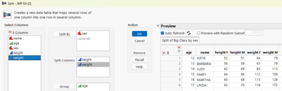

I was surprised just now to learn that if there are multiple split-columns for a given split-by column, then new numbered columns are created.

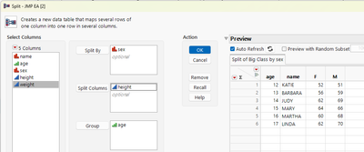

if multiple split-columns are used, JMP creates the column names as a combination of the name of the split-column - and the entry of the split-by-Column:
I only one column is selected as split-column, the name of the split-column is not included in the column name:
My colleagues roll their eyes when I start using Big Class to explain a functionality of JMP.
But it's a wonderful trick to use an alternative data set to play with the settings:
with "M" and "F" it's obvious what JMP is doing, no need to wonder about the "numbers" that appeared with the original data set.
Big Class looks very simple, but it's complicated enough to explain  many of the details.
