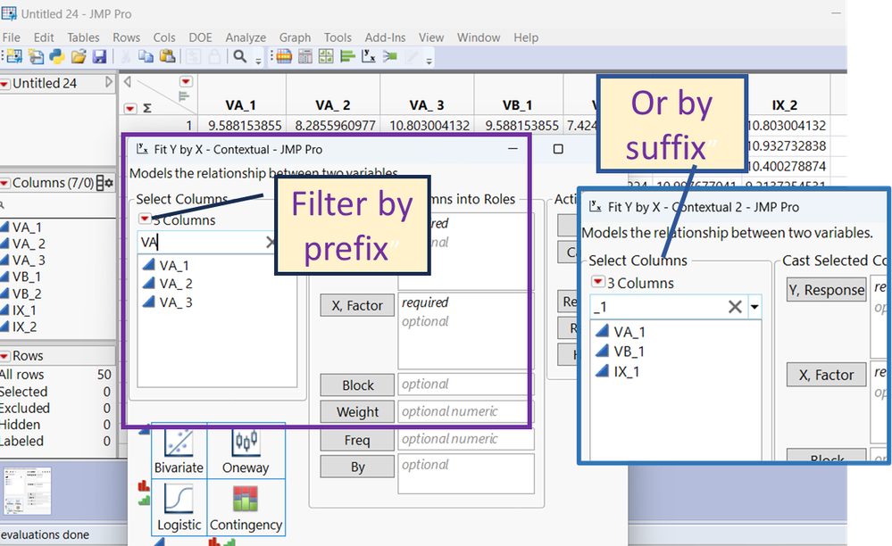

Hello-
It sounds like you have found a workable solution- that's great.  There are usually several ways to approach a problem, and sometimes others can benefit from tips/tricks learned here.

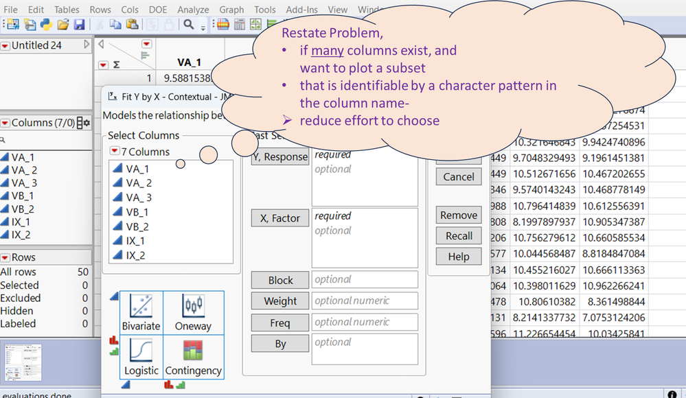

>>I will admit that I was unsure of the exact problem from your description, a sample illustration would have been helpful.
Some thoughts on "a" problem (if it incorrectly matches yours- perhaps others will find some use).

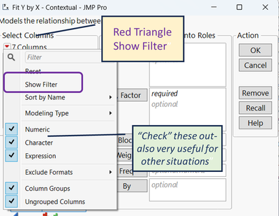

Column Select has filter options under the red Triangle
Depending on the nature of your column names- the search may allow groups of the type you desire.
