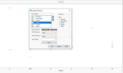

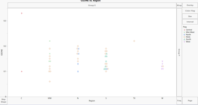

Hello,
I am trying to create a GraphBuilder plot, with a "Flag" column being used in the "Color" section as show below
I want my script to autoexclude a particular category, lets say "PASS" in this case. I am not sure on how to do that. Any suggestions would be very helpful
Thank you.

You want to just hide the marker? Couldn't that cause confusion to the reader as there are markers in the plot but not explanation to them at all?
I'm not sure if there are any very easy ways of doing this besides doing it interactively and then copying the script. Based on JMP created script this looks to be legend item position dependent thing (seems like index starts from 0 here... and index 1 is set to -1 to hide it).
Graph Builder(
	Variables(X(:height), Y(:weight), Color(:sex)),
	Elements(Points(X, Y, Legend(18))),
	SendToReport(Dispatch({}, "400", LegendBox, {Legend Position({18, [0, -1]})}))
Here is maybe a bit more robust option using Legend Display (see LegendBox object from scripting index)
Names Default To Here(1);
gb = dt << Graph Builder(
	Size(534, 456),
	Show Control Panel(0),
	Elements(Points(X, Y, Legend(1)))
lgnd = gb << Get Legend Display;
items = lgnd << Get Items;
For Each({item}, items,
	show(item << get label);
	If(item << Get Label == "M",
		item << Set Visible(0)
-Jarmo
