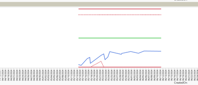

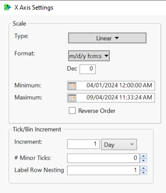

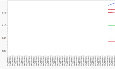

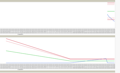

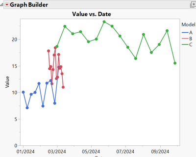

When doing graph builder, the date is on an x-axis. I then fixed the date column's axis properties to make sure the increment for date is by 1 day. Some set started to have data for the past 5 months, while some only started to have within the last 2 months or few weeks. If I were to fix the column property for the axis, it will then take the overall oldest and most recent date in the database table. By doing this, I will have many blanks in graph builder (as shown in picture).

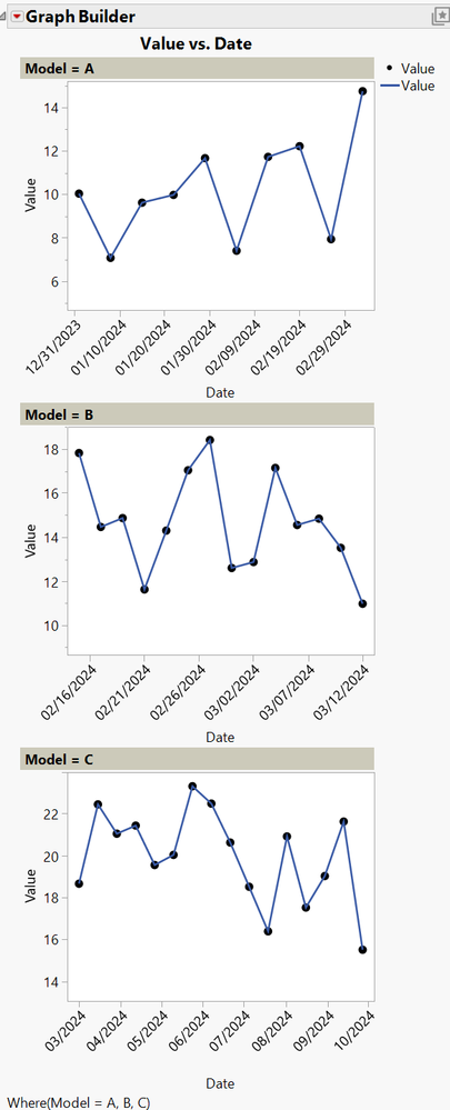

Graphbuilder will automatically determine the needed range of the X (time) access, based on the span of the data included in that graph pane.

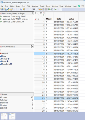

Sample Data, Three car "model", with random "values" on "dates" in a Tall table.
For graph cosmetics- Dates for information about each "Model" do not need to be on fixed or aligned intervals (sample data made at 2 day, one week, and two week intervals)
When several Models are included in the same graph Pane- the Date axis will stretch to include all points. From your description this is not desired.
Overlay

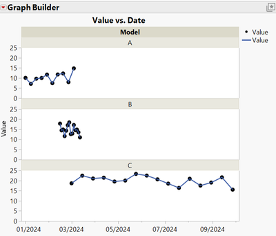

Wrap, with levels per row forced to 1, is shown below.   Using Model in "Group Y" would be similar.
But when "Model" is in the "Page" drop box- each graph is independent and will automatically set date span to show relevant data.   If this is easily understandable by viewers, then it seems to answer your question.  Note that time is on different scales, and it may be difficult for viewers to mentally adapt the shape of the profile to the individual timespan as they view several graphs together.

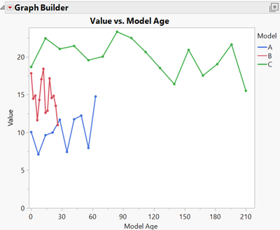

Another option to consider in situations where the Age (or time since model first released) is relevant- is to calculate an Age vs model introduction, and chart against that scale.  This loses the Calander connection to model release date- but Time remains proportional and any trends of models relative to their release date remain viewable.
Overlay
