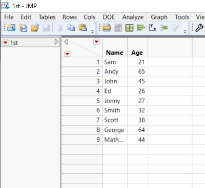

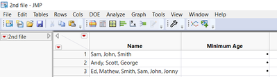

I have 2 files.
1st file:
2nd file :
I am trying to write a script which will search for the Minimum age from the 1st file and assign the lowest age in the 2nd file
For e.g.
The 1st row which has three name Sam, John, Smith so the Value in the Minimum Age Column should be Min{Sam, John, Smith}  Min{21, 27, 32} = 21

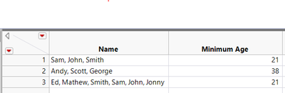

my final output will look something like this:
Any suggestions please?

2nd file doesn't have Minimum Age Column. How can I create the 2nd column with name "Minimum Age" and then assign the lowest value?

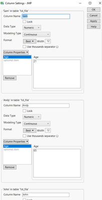

Hi @txnelson ,
What if the Age values are stored in column properties? How can I import column properties (Age) of 1st_file into the column (Minimum Age) of 2nd file

First, I need to clarify some terminology.
  1.  In data table 1st_file, you have 9 columns
  2. In data table 1st_file you have 1 row of data for each column.  You do not have what JMP refers to as column properties.  If you right click on a column header, and select "Column Properties", you will see an extensive list of items that refer to the particular column that you selected.
I mention the above, only because when you used the keywords, Column Property, I immediately went to the idea of JMP Column Properties.  That setup a bunch of false assumptions which lead to a bunch of confusion for me.

1.In data table 1st_file, you have 9 columns Yes
Can I import these extensive list values into column of 2nd_file?
Can we use the syntax "Get Property()
For e.g.
dt1 << Get Property("Age");
and then use for loop to assign it in the 2nd file?
Thanks again
txnelson
Re: Assigning Minimum value to a column
The syntax for get property is
obj << Get Property( the property you want to retrive );
Therefore you would ask for one of the Column Properties for the column Age as:
:Age << Get Property( "Spec Limits" );
// or
Column( "Age" ) << Get Property( "Units" );
And JMP allows one to create their own Column Properties, so you could do something like
dt1:Sam << Set Property("Age", 3);
dt1:Andy << Set Property("Age", 4);
theAge = dt1:Andy << Get Property( "Age" );
Jim
