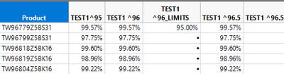

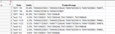

I want to assign values from table 1 (dt_group) to table 2 (dt_subset).
So iterate through each row of Table 2 and then compare the rows of the table 2 Product column with each row of table 1 ProductGroups and then assign the Limits values to the _LIMITS column in table 1 if matching sting is found. How would I script this?
table 1:
table 2:
I already tried and have problem with comparing strings from both tables...

Thanks, Jim! Not exactly what I am looking for.
An example:
compare Product Column row 1 of table 2 with all the strings in the first row of ProductGroups and then assign the corresponding limit value
