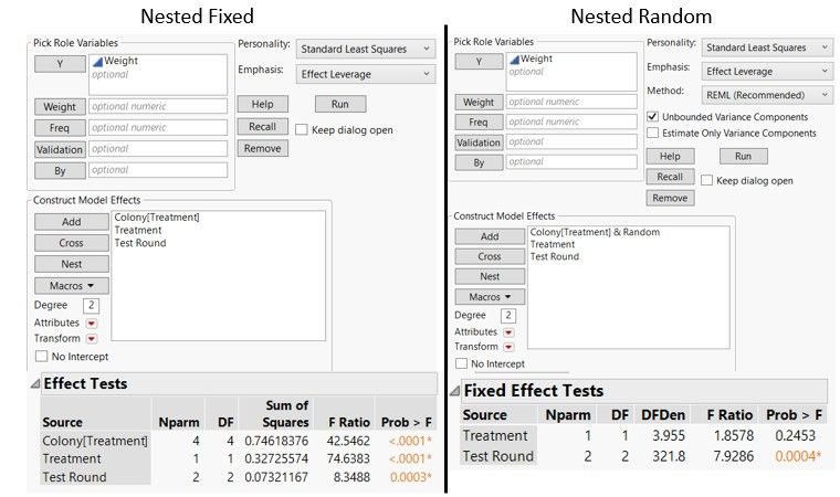

Question: How I include colony, as a random or fixed effect, nested under treatment has a major implication on the statistical outcome of the analysis (see output). Should [colony nested under treatment] be a fixed or random effect?

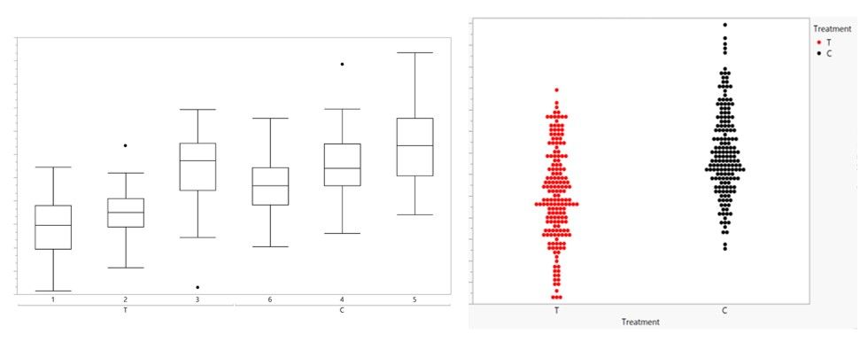

Looking at the dataset globally, it is clear that there is a treatment effect, but it appears that one of the colonies was unaffected by the treatment (see image). This leads me to think that there is a colony by treatment effect and that some colonies are more tolerant to the treatment while others are not. I am aware that with a non-factorial design (no crossing) I cannot prove this statistically. With the fixed model I get significance of the nested colony treatment and the treatment itself. When ran as random I lose the significance of the treatment variable. I don’t understand how randomizing the effect of colony can be separated from the treatment effect in an instance like this. Before I get called out for my non factorial design, let me say that there would be no practical way to cross in this type of study.

No, nested effects need not be random. The domains in which 'experts' opined about the impossibility of a fixed nested effect might not offer examples, though.
Yes, if colony represents a sample of a population of colonies, then it should be modeled as a random effect in your case.
Regarding your conclusion, "Looking at the dataset globally, it is clear that there is a treatment effect, but it appears that one of the colonies was unaffected by the treatment (see image)," I think that you are confusing the fixed effects (treatment) and the random effects (colony). The random effect is about variation. The fixed effect is about the mean.
