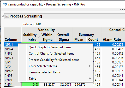

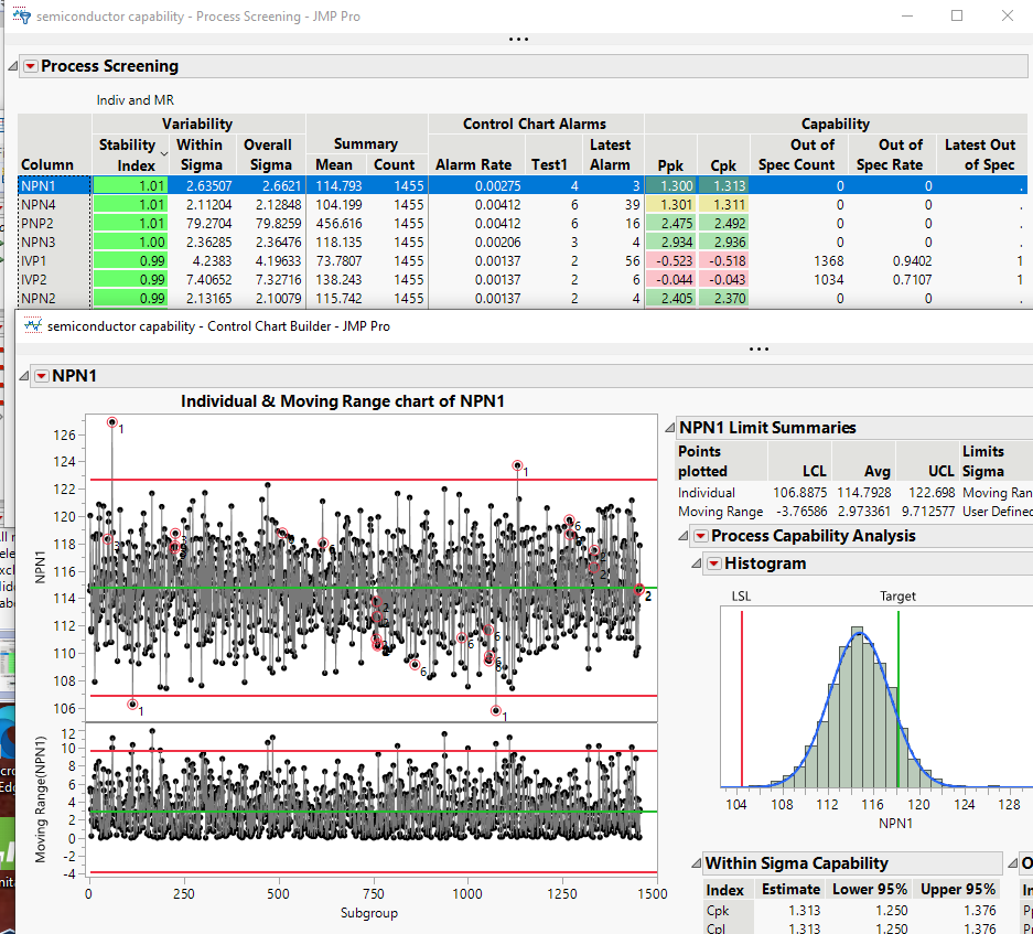

If you select any of the rows in the Process Screening report, you can then right click and there are several options that allow you to drill down to the details of the specific parameter.process1.PNG
Jim
