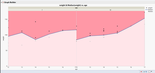

I was looking for how to fill in an area above a median line in Graph Builder.
But found out that I can do it opposite way.
By using 'Area' chart type to fill in an area below 'Median' and then change background color to be darker.
Any other approach possible?

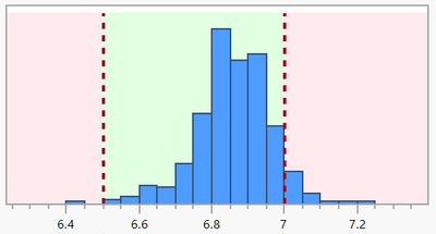

I like to right-click, customize, and add polygons: here is an example with the Distribution platform to show out-of-spec areas:
-Dave
