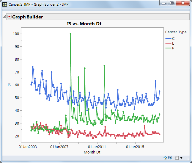

The code below adds a numeric date column (assumes 1st of every month) and creates a graph using Graph Builder.
dt = data table("CancerIS_JMP");
dt << New Column( "Month Dt",
		Numeric,
		"Continuous",
		Format( "ddMonyyyy", 10 ),
		Input Format( "ddMonyyyy" ),
		Formula( Informat( :Month || "-01", "yyyy-mm-dd" ) )
gb = dt << Graph Builder(
	Size( 530, 452 ),
	Show Control Panel( 0 ),
	Variables( X( :Month Dt ), Y( :IS ), Overlay( :Cancer Type ) ),
	Elements( Line( X, Y, Legend( 15 ) ), Points( X, Y, Legend( 16 ) ) )
You can do a visual inspection to see there are any upward trends.  If you need something more quantitative you could fit a model.
