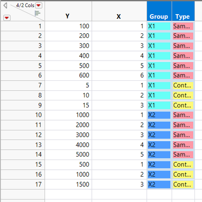

Trying to write a script to perform curve fitting based on user selected columns.
In the example below, the goal is to fit linear with X and Y based on :Group and/or  :Type. User can select either or both columns and then run the script.
This is what I've got
dt1 = current datatable();
sc = dt1 << get selected Columns;
scn= column (sc) << get name;
show (sc);
show (scn); obj = dt1 <<Fit Curve( Y( :Y ), X( :X ), Fit linear, By( scn )
// By (sn) );
In Log
show (sc); spits out:      sc = {:Group, :Type};
show (scn); spits out;      scn = "Group";
In Fit curves, neither "By (scn)" nor "By(sc)" can achieve the function of "By (:Group, :Type) or By(:Group).
What is the correct code to make this work?
Thanks!
