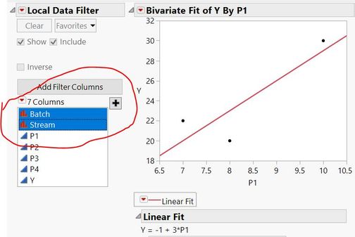

Go back to the Bivariate Fit red triangle and choose Local Data Filter.
Under the Local Data Filter section, highlight Batch and Stream, and click the "+".
You can now choose any Batch and Stream combination and JMP will update the analysis for that subgroup. Note that using the six rows you mocked up in your original post, you will not have enough data to perform regression for many of the subsets. So, I hope you have more data than your mockup.

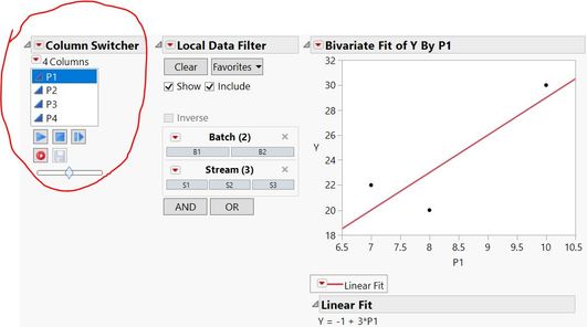

Now, to switch the P1 to a different P# column, do this.
Go back to the BIVARIATE red triangle and choose Redo > Column Switcher.
In the dialog that appears, select P1 and click OK.
In the next dialog, select P1 through P4 and click OK.
Clicking on a different P# will automatically switch the X-axis on the analysis.
I do believe this will give you what you requested, but I would encourage you to consider a single analysis rather than multiple analyses and this "subsetting" of the data.
