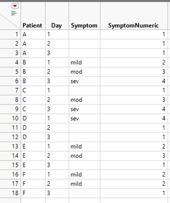

I am using jmp 15.0 and have diary data to analyze. Patients had to record symptoms for 3 days (fictive example), either no symptom occurred (blank), or mild or moderate or severe symptoms or any combination of these categories occurred.
I would like to count the patients with always the most severe symptom occurred within those 3 days e.g. a patient with symptom severe on day 1, moderate on day 2 and mild on day 3 should be counted as patient with severe symptom.
I attach a sample file with the data structure for clarification and the outcome should be

Most likely there is even easier way, but you could first recode/use formula to change those Character categories to numeric values:

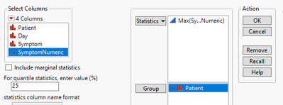

Create summary table (or use tabulate) with Max of the new column:

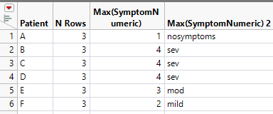

Recode values back to categories:
Create summary/tabulate of that:

Many thanks the steps as described by you are working well. I am still on a beginner level with jmp and not there yet to script all that (my file has a lot of different symptoms in different rows) but I will look and get into it  step by step to manage that over time. For the time being - great that this works!
