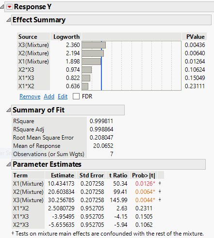

My notion might have been expressed previously in this discussion, but I want to state it explicitly. First of all, we would not test the main effect parameter estimates. Why not? The constraint that the component proportions sum to one has ramifications beyond the mathematics of the linear model. An effect is a change in the response when a factor changes its level. The changes in the factor levels are independent in a non-mixture experiment, so the effect of changing a factor is uniquely determined in a properly designed experiment. It is impossible to change one mixture component independently from all the other components. So we cannot uniquely assign the effect to one component in a mixture experiment.
Second, we cannot test the main effect parameter estimates. JMP incorrectly tests the parameter estimate for the main effects against a null hypothesis that the parameter is zero. The main effect parameter is the mean response plus the mean change in the response of a pure blend so the null hypothesis is the mean response, not zero. Furthermore, the joint tests are impossible because the mean response is part of all the main effect parameters.
The true mean response in this simulated data set is 20. The true main effect parameters, which include the mean response, are 10, 20, and 30 for X1, X2, and X3, respectively. The parameters are significantly different from 0, but that is the wrong null hypothesis. Each of the main effect estimates is flagged with the note that the tests are confounded.
We don't ask about the main effects, but we can and should ask about the higher-order terms because they tell us about the shape of the surface and are testable.
