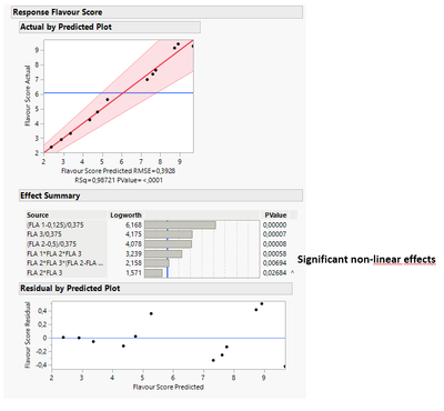

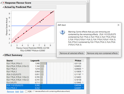

I am analysing a three factor FLA 1, FLA 2 and FLA 3 mixture DOE based on a full cubic Scheffé model. Pushing the standard least squares buttallon and trying to remove low effect parameters using backward regression baseo on the logworht pareto (P-values for mixture analysis?) I get the result below: should I also remove all selected effect or only non-contained effects?

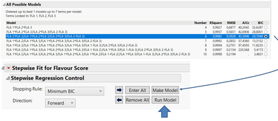

I also did the analysis with "All Possible Models" in Stepwise  and get a very nice model based on AICC ranking, maybe a wrong model (will P-value based backward regression generate a right model...?) however very useful to specify optimal output Y settings!

No matter if your DoE is a factorial or mixture one, if there is an assumed model a-priori, you should respect the three principles behind Design of Experiments :
  1. Effect sparsity: The effect sparsity principle actually refers to the idea that only a few effects in an experiment will be statistically significant. Most of the variation in the response is explained by a small number of effects, thus it is most likely that main effects (single factor) and two-factor interactions are the most significant responses in a factorial experiment. It is also called the Pareto principle.
  2. Effect hierarchy: The hierarchy principle states that the higher degree of the interaction, the less likely the interaction will explain variation in the response. Therefore, main effects explain more variation than 2 factors interactions, 2FIs explain more variation than 3FIs, … so priority should be given to the estimation of lower order effects.
  3. Effect heredity: Similar to genetic heredity, the effect heredity principle postulates that interaction terms may only be considered if the ordered terms preceding the interaction are significant. This principle has two possible implementations : strong or weak heredity. Strong heredity implies that an interaction term can be included in the model only if both of the corresponding main effects are present. Weak heredity implies that an interaction term is included in the model if at least one of the corresponding main effects is present.
In your case, when trying to remove these effects, you are in conflict with the effect heredity principle : you can't remove main effect FLA1 and interaction FLA2xFLA3 unless you already have removed all other effect terms containing these terms. So here you should keep them.
As stated before, creating models based solely on p-value for mixture designs may be very misleading.
The second option you tried with AICc (or BIC ?) criterion seems more reasonable, as AICc (or BIC) is an information criterion trying to "balance" the complexity of the model with its accuracy (the lower, the better).
Regarding your screenshots, it seems that models with higher number of terms may be useful in your case, as model number 9 has lower RMSE and lower BIC. It may also correct the residuals plot that seems to show some kind of heteroskedasticity (bigger residuals for higher flavour score).
