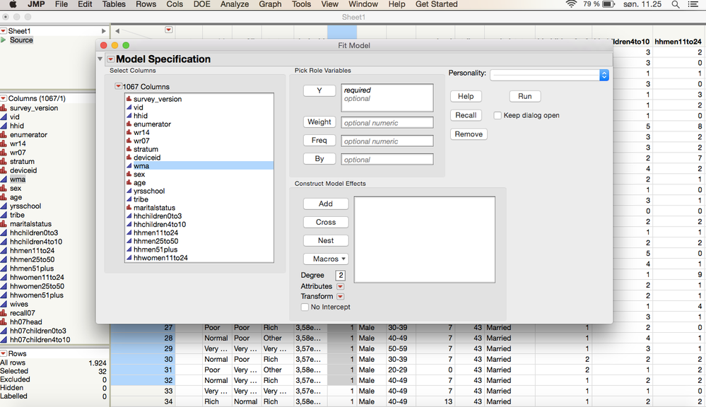

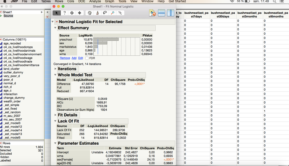

When I enter the Fit Model option, this is what I get:
I add the new "Selected" column that I have created as Y and then throw in the variables that I want to add (in this case sex, age etc) in the Contruct Model Effects box. I don't see any of the options that you you mention?
When I apply the analysis, I get the statistical results but nothing that looks similar to yours.

If you can't view the screenshot in my previous post, here it is againSkærmbillede 2018-09-16 kl. 11.25.29.png

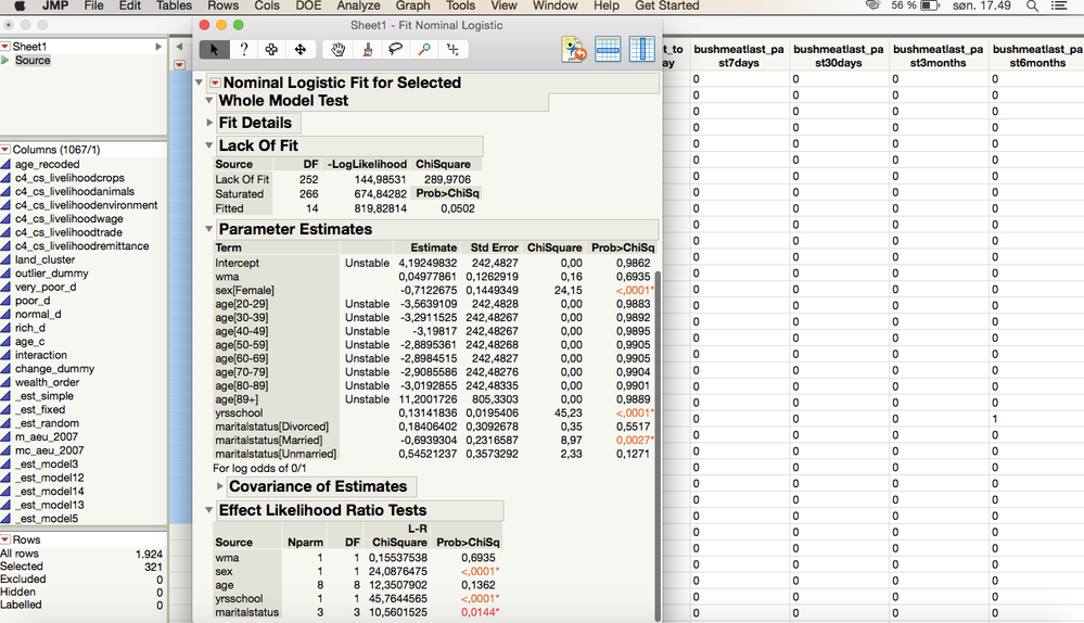

OK, so I ran a test on the column that I am interested in on specific rows that I had selected and got this:
Skærmbillede 2018-09-16 kl. 17.49.42.pngSkærmbillede 2018-09-16 kl. 17.49.52.pngWhich I pressume means that the "red" p-values are the ones which have a significant effect, right (in this case (sex female, yrsschool and maritalstatus married)??

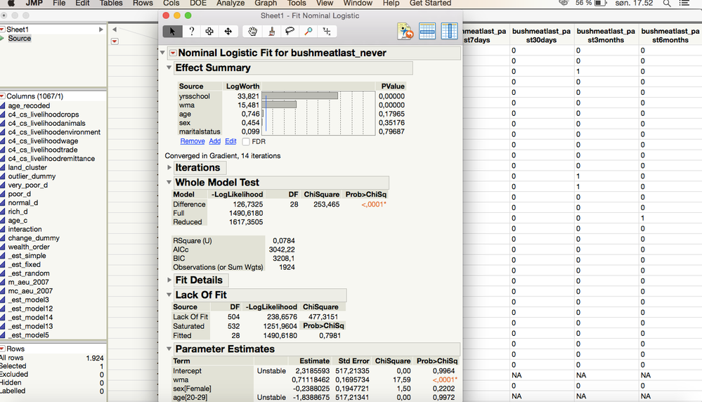

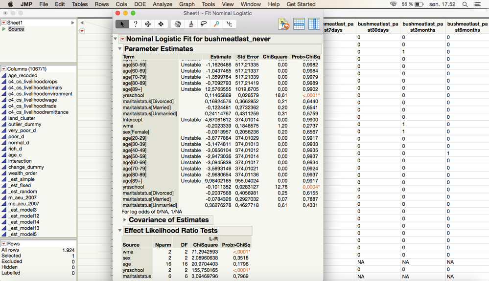

I also tried doing the model for the entire column, without selecting specific rows (which would be the simplest way for me to analyze my data) and it came out as this
 Skærmbillede 2018-09-16 kl. 17.52.13.pngSkærmbillede 2018-09-16 kl. 17.52.21.png
 For some reason when I do this, the model is analyzed twice in the Parameter Estimates, which I don't understand why?

I don't know about the analysis appearing twice, but I see two other problems.  Both of your analyses (the one for the selected rows and the one for the whole column) are using all of the rows.  Once you select the rows, you must either subset them to do an analysis just on those rows - or, as I am suggesting, make the selected rows a new column (1=selected, 0=not selected) and put that column in the By box when you launch the platform.  Then you will get two analyses - one for the selected rows and one for the others and you can compare them.
The second problem is that your model is trying to fit a response variable with 3 levels - 0, 1, and NA.  While this can be done, I think you really are tryiing to build a model to predict the 1 values.  Your variables appear twice because they are trying to predict 1/NA and 0/NA.  It would help if you would post a screenshot of the Fit Model dialog you are using.

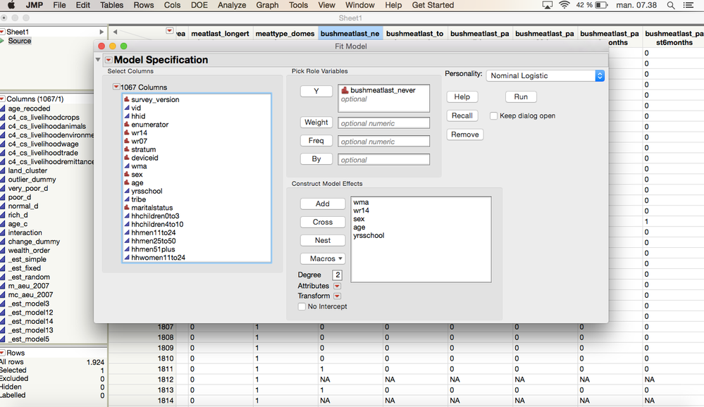

So this is how it would look before I run the test:
I want to test which factors affect the column (Bushmeat never consumed). The variables are wma(0 and 1), wr14 (very poor, poor, normal, rich), sex (male, female), age, yrsschool and marital status (Married, unmarried, widower, divorced).

How many levels does your Bushmeat column have?  From what you have said, I think you want to, but your prior analysis makes me think there are 3 levels - if NA is in that column, you should change it to missing.  Also, the box near the middle of the Fit Model Box says "By" and that is where you should put the column that identifies the selected rows.  That is what will give you a separate analysis for the selected and unselected rows.  If you don't care about that comparison and only want to analyze the selected rows, subset them before doing the Fit Model.

The Bushmeat column has two levels, yes. 0 and 1 corresponding to a yes or no answer. The N/A is if there was no answer given, so I think you are right that I should remove those. I did that and that took care of the problem with the analysis being run twice.
Thanks!

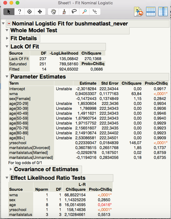

As of the analysis itself, I get this result for one of the tests
Skærmbillede 2018-09-18 kl. 09.07.14.pngI
I interpert this as there being a significant effect of the variables "wma" and "yrsschool" and that the Effect Likelihood Ratio Tests indicates that for "wma" it is for the value being 1 that is significant, as well as 1 being the value of significance for "yrsschool". Correct?
