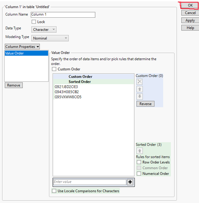

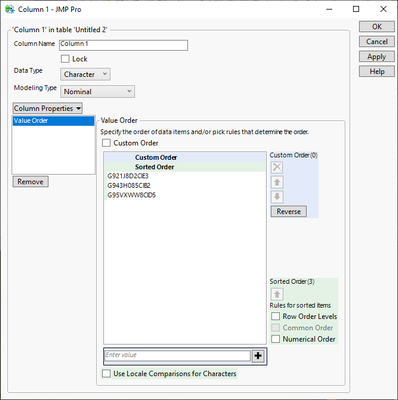

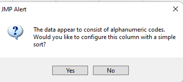

Also, if you add a Value Order property to the column, JMP should immediately recognize that your data are alphanumeric and ask if you'd like to configure it with a simple sort. If you answer yes, then hit ok in the following dialog (i.e., don't adjust anything, just accept), then the sorting will work as you expect.

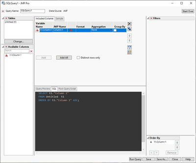

I'm not sure if you can affect how the sorting is done without using Column Properties. You could create "support" column which you can then sort by to get the order you want or you could maybe use Query Builder
or use Value Order Column Property
EdHutchins99
Level I
Re: Alphanumeric sorting rules in JMP17
Thanks, everyone!  Setting the Value Order property, then sorting, puts the values in the order I expected.

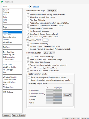

txnelson
Your preferences are set to Numerical Ordering.
Go to
     File=>Preferences=>Tables
and unselect the checkbox for Numerical Ordering
