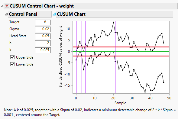

Thanks for that.  But its not quite what I was looking for. In the control chart as per below, there are 7 points on which a shift is detected, as indicated by the vertical lines below. Screenshot 2024-09-08 162150.png
I was then expecting my code below to populate the ReportOut Datatable, with 7 rows of data, with the alarm script running once for each shift detected.

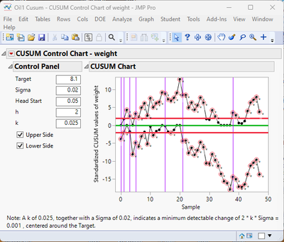

However looks like the alarm script wont run at all, unless Test beyond limits (1) is used. This then results in all points out of control in the chart being circled (71 in my example) , and therefore 71 rows of data being added to my ReportOut Data table.
Ultimately, I want  the alarm script to run only when a shift is detected, and then output information on the shift to a ReportOut Data table, with information like the Sample Number on which the shift was detected. Maybe I'm misunderstanding how the Alarm script is indented to function?

possibly, but would seem strange, given the purpose of a CuSum graph is to detect a shift in data, and this is indicated in Jmp with the vertical purple lines as per above.  Its on a shift in data a user would want the alarm script to run.
