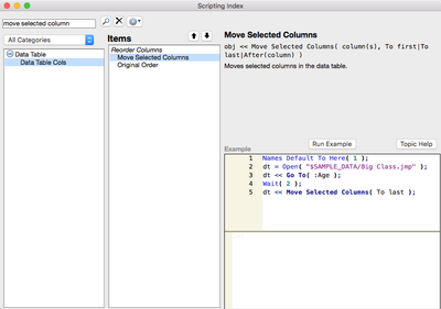

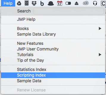

Jeff_Perkinson
Re: After Creating a new column how do you move it so it becomes the first Column using a Script?
BTW: If you haven't already found it, the Scripting Index under the Help menu is your friend.
-Jeff
