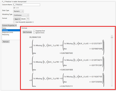

Tree-based models are simple in their mechanisms, as they rely on if-else statement using thresholds values on the factors.
If you want to use your tree-based model in Excel, you can  save the prediction formula in JMP, and replace the if-else JSL functions by the corresponding Excel functions. However, Boosted Tree and Random Forests can have quite complex (and long) prediction formula :
