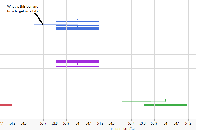

I have added the intervals as suggested, but frankly I do not understand what it is.
Now it is plotted as: Mean as a dot +/-SD as bars
And I have zoomed in the graph.
1. Why are they different widths? What else is plotted there as a thick line - a median or a mean of my SD? How do I get rid of it then?
2. Then, how does each bar relate to the mean - how are they connected, which mean belongs to which bars? Can one just make a line going through the center of the points as in all other stat softwares?
I cannot easily understand. I think this could be improved...?
Re: Adding the user-defined error interval option to the graph builder
I can't really tell how you created your graph, but it looks like you do not have a grouping variable defined, so you are getting intervals for each data point. See this example:
I had a data table with 3 columns: Group, Y, and Interval.
I drug the Y column to the Y-axis. I then drug Group to the X-axis and Interval to the Interval role to create the graph. Note that the Interval column is only needed because you wanted a Custom interval. If you just want something standard, you can drag the Y variable into the Interval role and specify the statistic you want to create the interval.
I believe this is the type of interval graph that most people expect. Perhaps if you share a bit more of your problem setup (or a fictional example of your data), people will be able to help more.

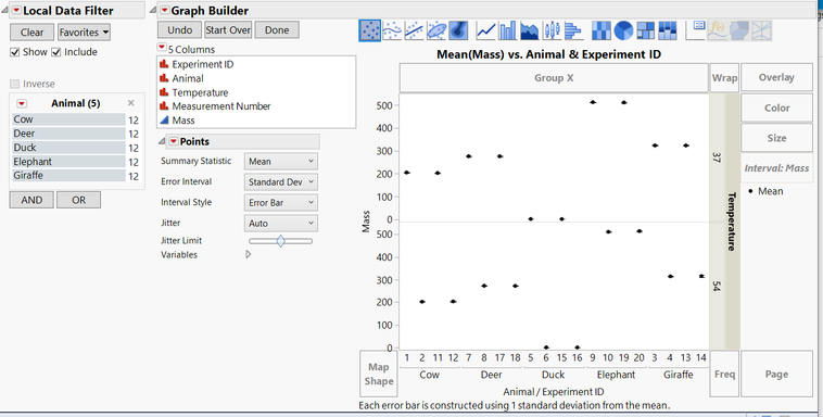

I have added a dataset with raw data. If you were asking this, cows at row 1 and row 11 are also different cows (let us call them A and B). I just plot them together side by side at 37 with their own means and their own SDs. And cows at row 2 and 12 are also different (let us call them C and D). So I have 4 cows in total, two measured in 37 two at 54 - by random technicians in random days, independent samples etc etc.
That is what I thought. In order to keep the intervals from being combined, you need to specify the animal ID as part of the graph. Otherwise there is no way for JMP to know that the first cow is different from the second cow. You can create this from the summary table like this:
But you do not need to have the table summarized. From the raw data, I stacked the measurement columns (data table is attached). I then put the mass measurement as the Y and as the interval, animal as the X-axis and Experiment ID as the nested x-axis variable. Because the animals are so different, the scale is too small to see the error bars, so I added a local data filter that would allow me to choose the animal type to see the graph more easily. That is saved as a script on the data table.
