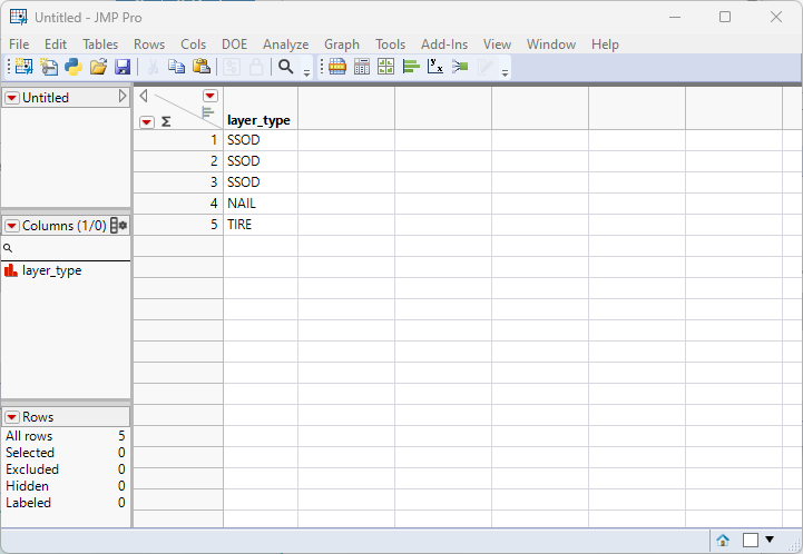

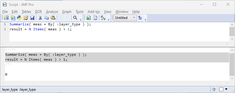

This case exhibits only the value "SSOD" so it should return 0:
The result is 0:

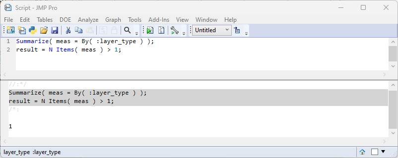

Another case exhibits values other than "SSOD: so should return 1
The result is 1:
