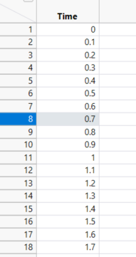

I'm trying to add a new column and increment each row by 0.1.
i have thousands of rows.
I am using the sequence function my question is.
in my example:
I start from 0 to 10- incrementing by 0.1 and repeat 1
I want to Start from 0  to the last row. would put in a huge number?

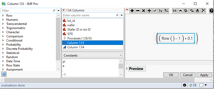

You can put in a very large number
or you can get the same results without the need to use a very large number by using this formula
and as can be seen, both approaches result in the same values
