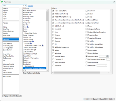

I am looking to add "custom" statistics to the summary statistics table within the "Analyze" platform, similar to the mock-up below. The list of additional statistics within the customize statistics window does not have what I am looking for so I want a way to add my own calculations. I get the impression that this may not be possible within the Summary Statistics table, so any guidance on how to accomplish this within the "Analyze" platform would be greatly appreciated as it does 95% of what I am looking to do already.
I am new to JMP so apologies for any incorrect terminology. JSL guidance or suggestions are welcome and appreciated.

| Posted in reply to message from Connor_K 07-17-2023
Modifying the existing platforms isn't usually that simple but it can be done through scripting. If you commonly perform similar analysis it might be easier to script your own report (script or add-in) which uses distribution platform for some analysis and then has additional summary statistics somewhere in the UI. It is also possible to create a script (or add-in) which will manipulate existing distribution platform and adds summary statistics there

In addition to what @jthi has mentioned about scripting, where you can generate your own interface and statistical values, you might try checking out the Distribution Summary Statistics to see if the statistic you're after is already built into JMP.
Go File > Preferences > Platforms > Distribution Summary Statistics, and check/uncheck the boxes for the statistics that you want to appear or not appear.
Unfortunately the statistics I am interested in are not included in the preferences section you have mentioned. The statistics I need are proprietary and a bit esoteric. I appreciate you taking the time to share that information though!
