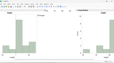

Hi,
I want to put several graphs in a single plot and use the Graph Builder together with V List Box and H List Box. I want to add vertical lines to the plots. I found the example by @jthi, however I get problems as soon as there a several plots.
The example below works with a single plot, but when I uncomment the second plot, I get an additional axis between the plots (see below). How can I fix that?

2 ACCEPTED SOLUTIONS
hogi
Level XIII
Re: Add vertical lines to Graph Builder in H List Box
In New Window, different display objects can be listed by separating them with commas:
gb = graph Box ();
new window("test",
Text Box ("Hello"),
gb [Axis Box (2)]
creates a new window with the text box and an Axis box.
If you want to add "commands to this list, you have to "close" the commands with ";".
For your case it's:
View more...

jthi
I would suggest moving the code adding reference lines outside of New Window as it is easier (in my opinion) to update and make modifications to (you can also do what hogi suggested).

hogi
Level XIII
gb = graph Box ();
new window("test",
Text Box ("Hello"),
gb [Axis Box (2)]
For your case it's:
View more...

hogi
Level XIII
I tried to add a screenshot, but Copy/Paste still seems to be broken on the Community
@Ryan_Gilmore ?
