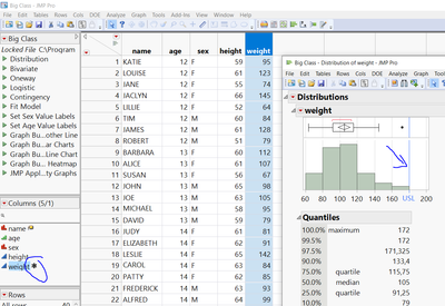

Another option maybe to add a column property spec limit, and let it show in the histogram of distribution platform.
The value can then be used for other platforms as well (process capability ...).

Re: Add Vertical Lines to Histogram
