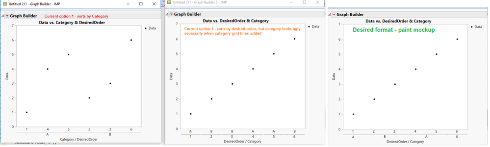

This is going to be hard to explain by text so please see images below. Basically I'd like to have grouped by category below the main x-axis without it messing up the sort order. Whilst it's possible to have category "above" the main x-axis, this doesn't look nice and causes category grid lines to be drawn every entry instead of only when it changes.

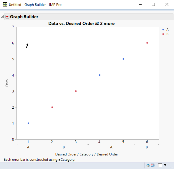

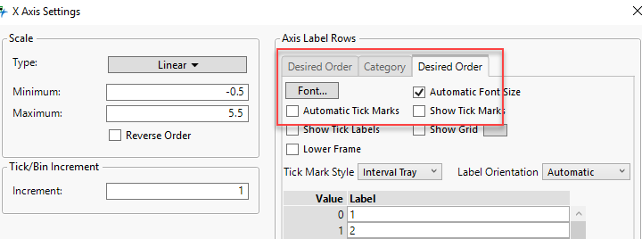

So You could readd the desired order below that even, then turn off the third axis.
Names default to here(1);
dt = New Table( "Test",
	Add Rows( 6 ),
	New Column( "Desired Order",
		Numeric,
		"Nominal",
		Format( "Best", 12 ),
		Set Values( [1, 2, 3, 4, 5, 6] )
	New Column( "Category",
		Character,
		"Nominal",
		Set Values( {"A", "B", "B", "A", "A", "B"} )
	New Column( "Data",
		Numeric,
		"Continuous",
dt = Graph Builder(
	Variables(
		X( :Desired Order ),
		X( :Category, Position( 1 ) ),
		X( :Desired Order, Position( 1 ) ),
		Y( :Data ),
		Color( :Category )
	Elements( Points( X( 1 ), X( 2 ), Y, Legend( 107 ) ) ),
	SendToReport(
		Dispatch(
			"Desired Order",
			ScaleBox,
			{Label Row(
				3,
				{Automatic Tick Marks( 0 ), Show Major Labels( 0 ),
				Show Major Ticks( 0 )}
		Dispatch( {}, "400", LegendBox, {Set Title( "" )} )
Hope that works for you.
