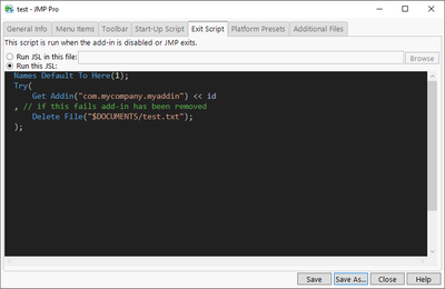

You can use exit script while checking if the addin still exists.
Example:

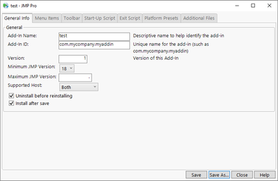

Create addin with com.mycompany.myaddin as ID

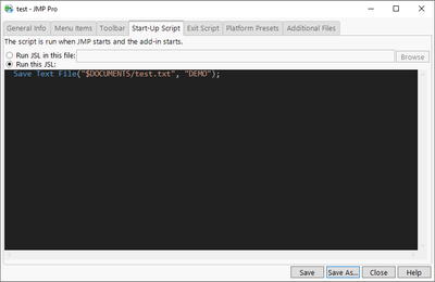

Somehow make add-in create some files (I used startup script)
And in exit script check for the addin using Get Addin + << ID + Try-catch
Names Default To Here(1);
Try(
	Get Addin("com.mycompany.myaddin") << id
, // if this fails add-in has been removed
	Delete File("$DOCUMENTS/test.txt");
Now when you close JMP the file should still be there but when you remove the add-in from View menu it will remove the file (at least did for me).
