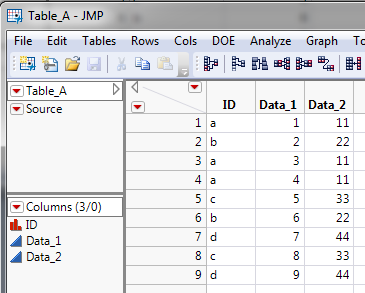

I have two data tables ("Table_A" and "Table_B"), both of which have a column "ID". They also both contain a column "Data_1", however with different values. In addition, Table_B has a column "Data_2".
11729_pastedImage_4.png11729_pastedImage_4.png11730_pastedImage_5.png11730_pastedImage_5.png
I would like to add Data_2 from Table_B to Table_A by matching the ID columns, however, Data_1 in Table_A should NOT be updated with the values of Data_1 in Table_B. This is the desired result:
The only way I have found to achieve this is by using the Join command, by giving the particular output columns I require:
However, this creates a new table. I would prefer Data_2 from Table_B to simply be added to Table_A, without any further modifications to Table_A (which is why I cannot use Update). Is there a way to achieve this?
