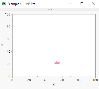

I can add formatted text at a specific coordinate using the code below at the time of making the Graph box.
New Window( "Example",
	Graph Box(
		Text Size( 20 );
		Text( {50, 20}, "label" );
However, I can't seem to figure out how to add text later, after the Graph Box has been created. For example I am actually trying to add multiple formatted text items to the graph box in a for loop.
I tried by identifying the 'inner frame box' for the 'graph box' and adding the text to it, but the frame box does not recognize the 'Text' message.  Ultimately, I want to be able to add multiple formatted text items at specific coordinates.

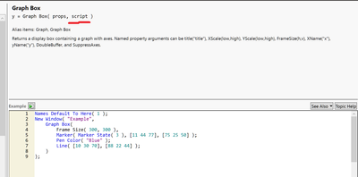

Notice how the final Glue() statement in the Graph Box() function is a script as shown in the help index (see below).  To add a script to a graph box after-the-fact, use the <<Add Graphics Script method, as below.  You can put a Glue() function here as I've done.
Names Default To Here( 1 );
New Window( "Example", a = Graph Box() );
frame = a[FrameBox( 1 )];
frame << Add Graphics Script( Text Color( "red" ); Text( Center Justified, {50, 20}, "centered" ) );

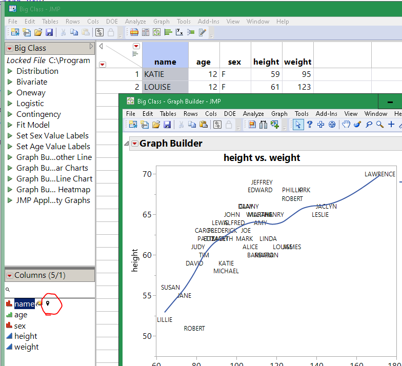

Depending on the goal, you might be able to use a data table and an existing platform and just label the points with another column. One of the column attributes is Use For Marker.
UseForMarker circled in red.UseForMarker circled in red.

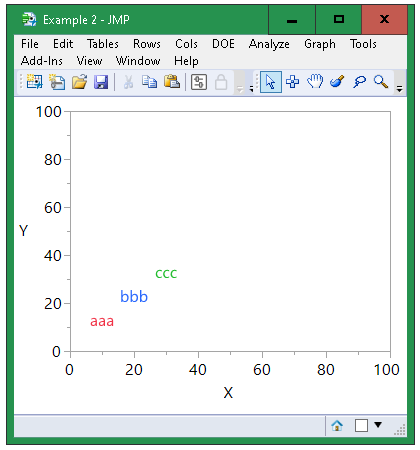

But to do what you describe, the graphics script needs to have a loop that gets labels (and color and marker data) from a container of some sort. The container can be a list, a data table, or an associative array. If you add a label to the container, you can send the <<inval message to the graph to make it redraw. When it redraws, the graphics script will process all the labels from the container.
list = {{"aaa", 10, 10, "red"}};
    gb=Graph Box(
        For( i = 1, i <= N Items( list ), i += 1,
            thisLabel = list[i];
            Text Color( thisLabel[4] );
            Text( Center Justified, {thisLabel[2], thisLabel[3]}, thisLabel[1] );
wait(1);
list[2] = {"bbb",20,20,"blue"};
gb<<inval;
wait(1);
list[3] = {"ccc",30,30,"green"};
gb<<inval;
Three seconds later...Three seconds later...
