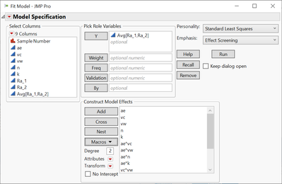

Is there any reason why you can't just take the average of the 2 repeats and analyse that as your response? You can create an average column by selecting the 2 columns (click and drag on the column headers), then right-click > New Formula Column > Combine > Average.
What is the objective of the experiment? The goal is important in understanding the appropriate analysis as different models are possible. It looks like it was probably designed to test a model with all main effects and 2-factor interactions. You would do that using Fit Model from the Analyze menu like this:

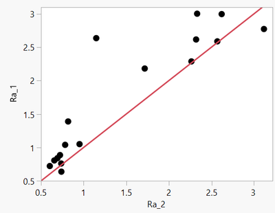

It might be a good idea to look at the correlation between the 2 repeats. For the most part they correlate well, but there is at least one (BV_11) where there is a bigger difference between repeats.
